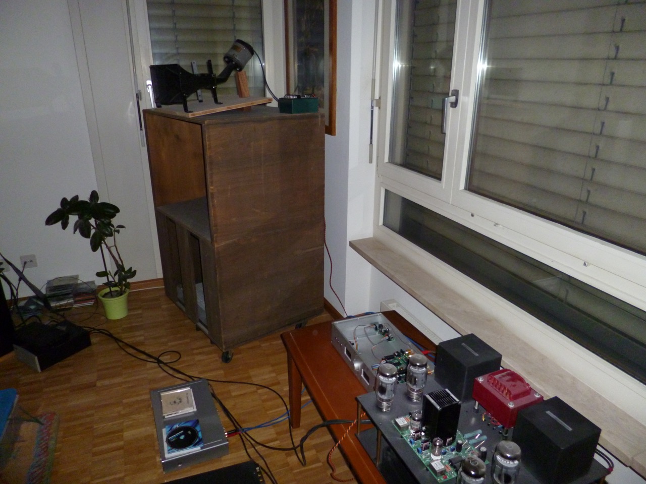

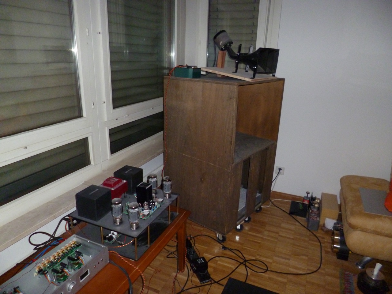

Ou la, des VOT à roulettes sur un plancher !

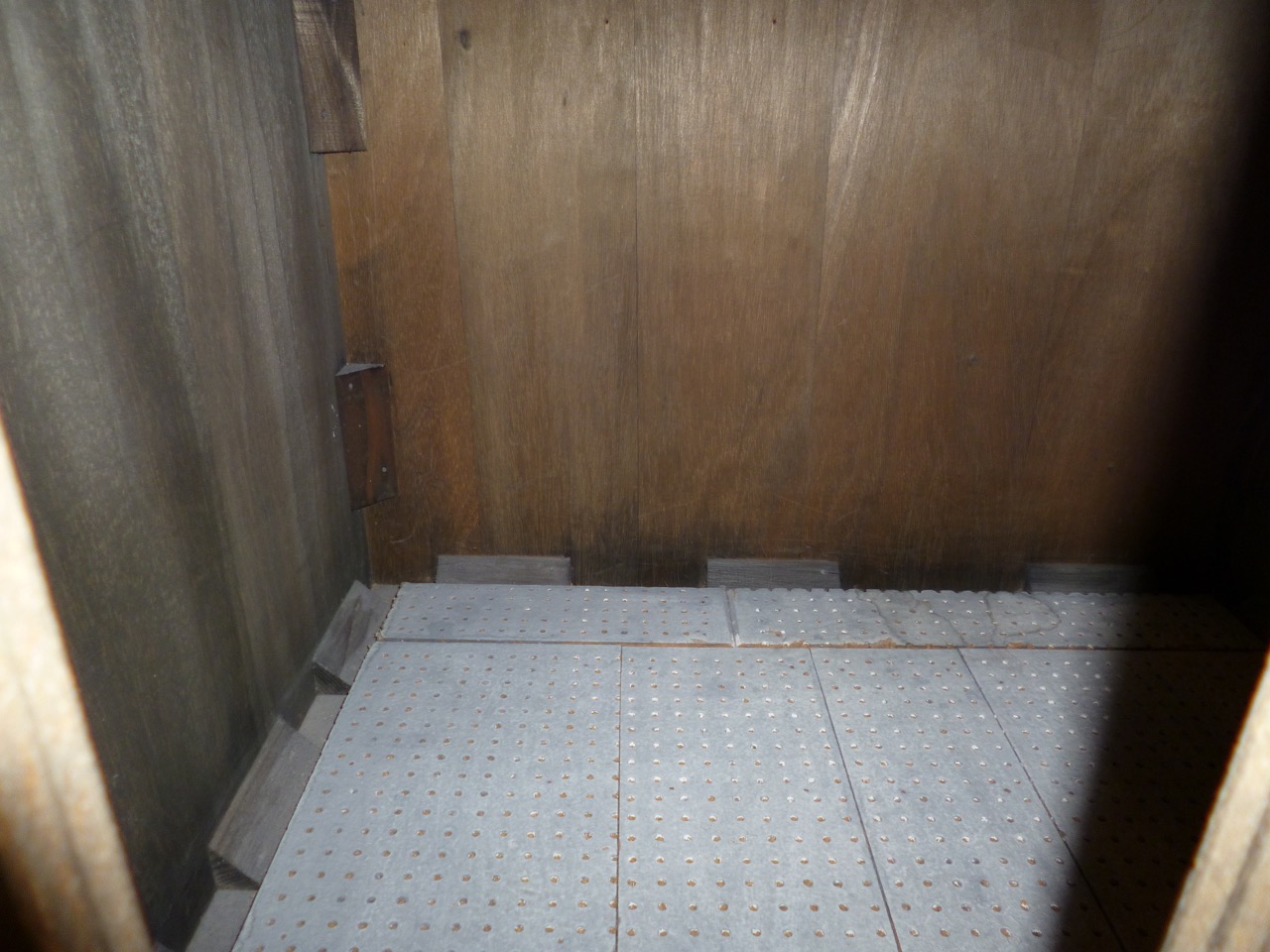

felix a écrit :Hallo Claude
The white board on the underside, is made of hard and light material. Probably perforated Pavatex. Dampen does not.
Best Regards
Felix
