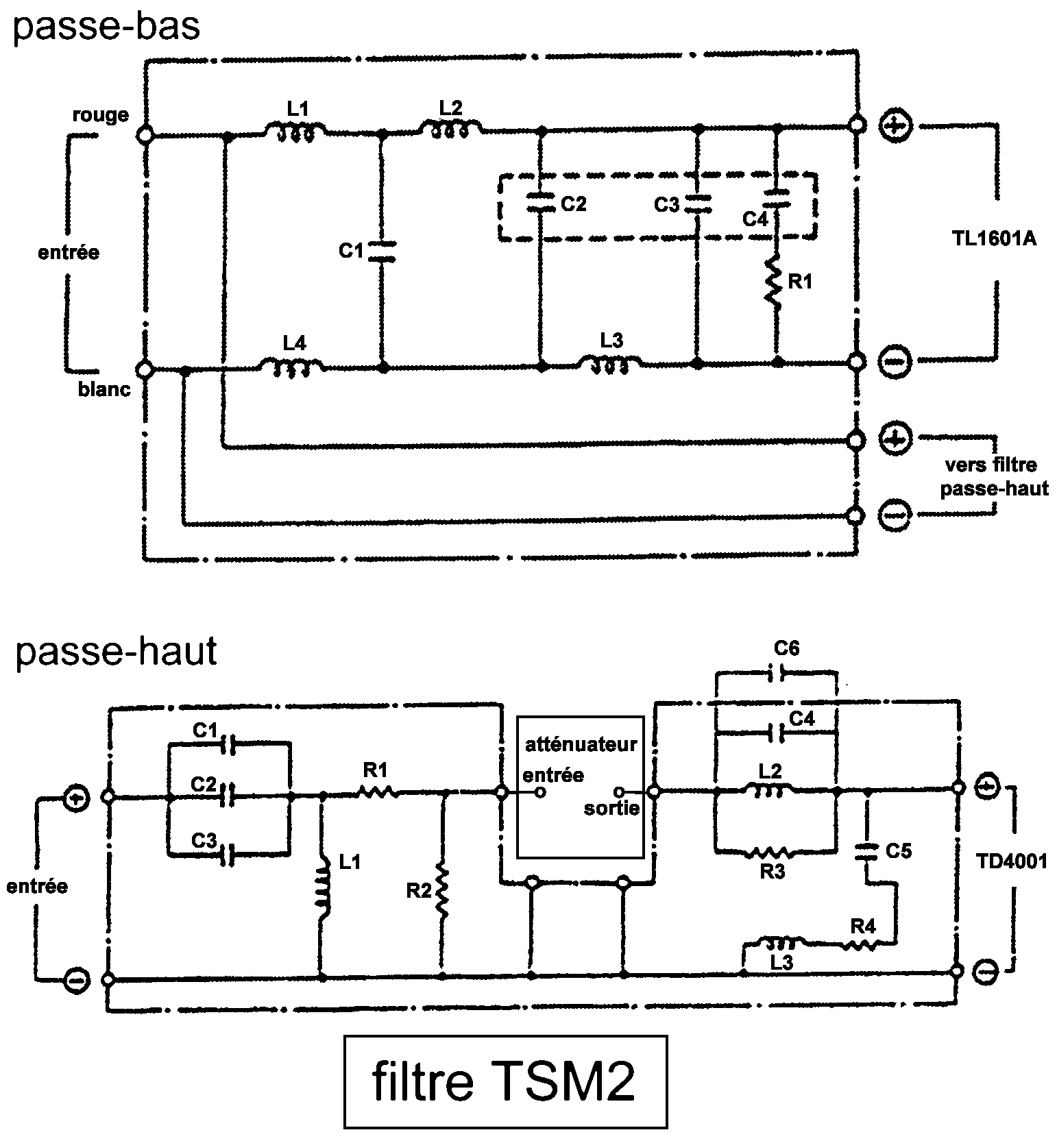

The passive crossover filters used in the TAD and Rey Audio (Kinoshita) monitors are all very similar, in their layout and basic functioning, to the TN-2 model used in the TAD TSM-2 (= Exclusive 2402):
TAD TN-2
The schematic is:
This filter consists of:
- 6th order Low Pass on the Woofer (in a semi-balanced topology, i.e. the first inductance is split in two halves and placed on either branch of the filter, and the following two inductors and placed on either branch),
- 2nd order High Pass on the compression driver+horn,
- plus impedance correction (Zobel on Woofer and series RLC on horn), and an equalization contour (parallel RLC) and L-Pad attenuation on the horn.
The purpose of the asymmetrical slopes (6th/2nd) is to compensate for the physical offset between the acoustic centres (based on the technical drawings of the TSM-2, the driver's diaphragm is ~33 cm behind the base of the woofer cone).

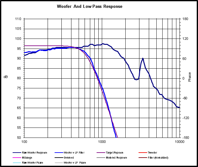

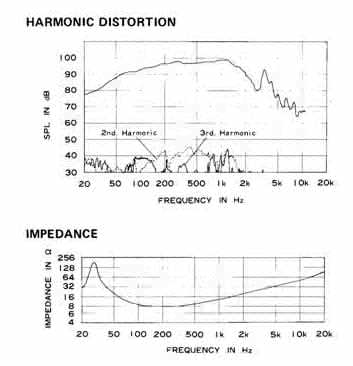

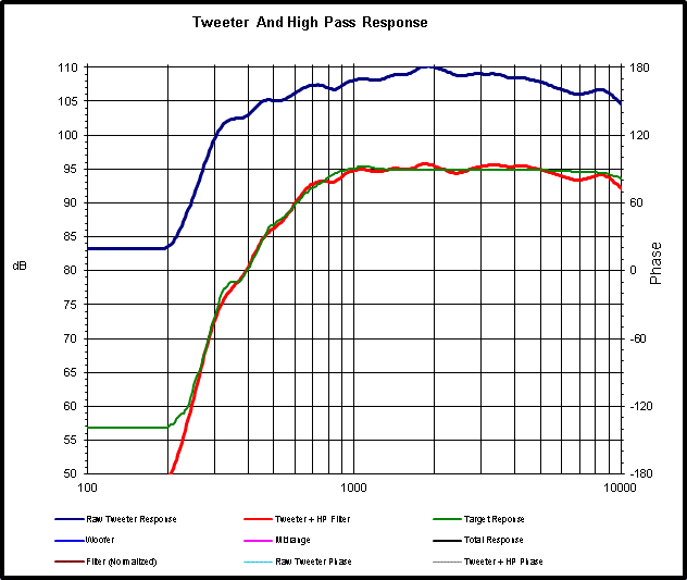

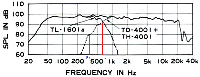

Having said that, based on the official published frequency response curves of the TL-1601a woofer and the TD-4001+TH-4001 driver+horn combo:
AND using the filtered responses as targets:
it is possible to reverse-engineer the passive crossover filter and obtain the correct L, C, and R values to employ:
Low-Pass Woofer (6th ord. Linkwitz-Riley @ 650Hz)

High-Pass Horn (2nd ord. Q = 0.9 @ 1.31 * 650 = 850 Hz)
C1+C2+C3 = 10+10+3.3 = 23.3 μF; L1 = 2.2 mH

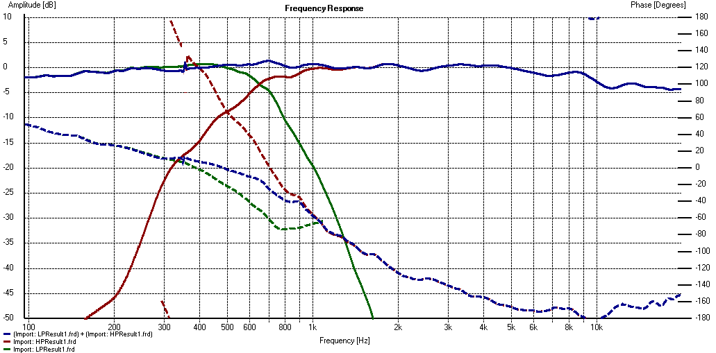

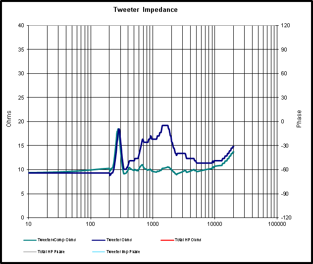

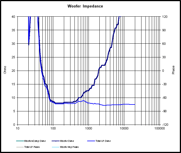

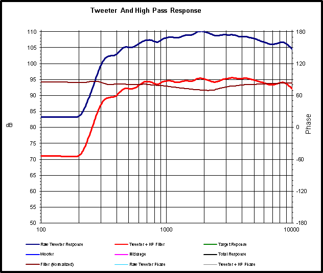

Here are the modelled results of the application of these values to the individual speaker units:
And the resulting simulated crossover, with the offset adjusted to 33cm:

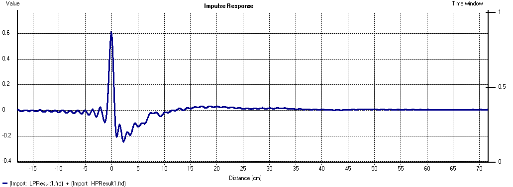

And the associated Impulse Response:
