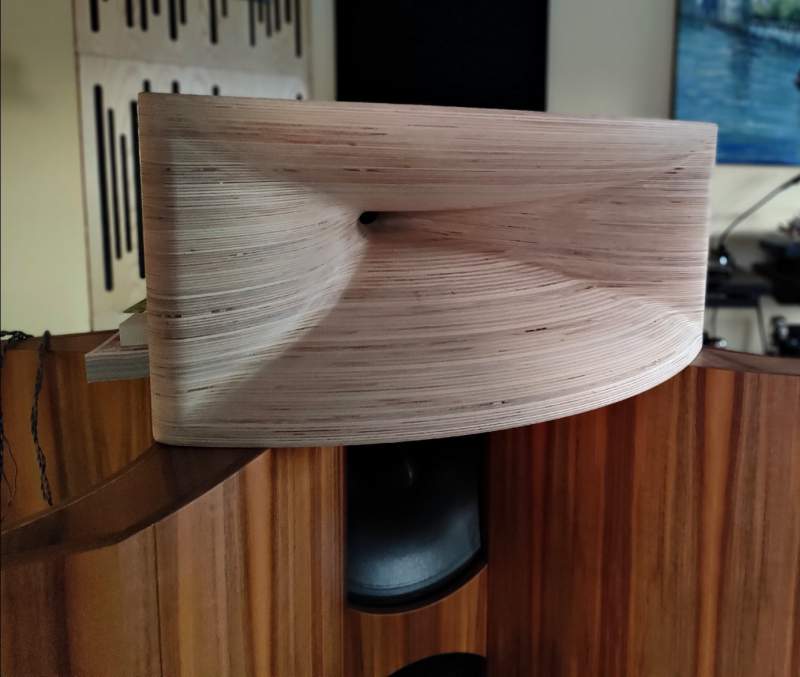

Finally, the prototypes arrived last WE. The William Neile horns are a revelation! They blamed the TH4001 in every aspect and what is the biggest surprise that the soundstage is more stable compared to TH4001. Up/down, left/right, forward/backwards, rotating the head: everything has a smooth transition and the soundstage is almost existing in extreme listening positions. They also bring a new level of upper bass precision and clean compression driver sound. The biggest advantage is the 3d sound stage improving much in depth. And all this comes together with perfect exponential loading.
There exist also a super ellipse version build by Don from Canada:

Finally, things come together!
Jens is moving forward and an accidentally "meeting with a legend" took place (sanding is still ongoing):

almost finished the raw wood part

Beautiful, congratulations
