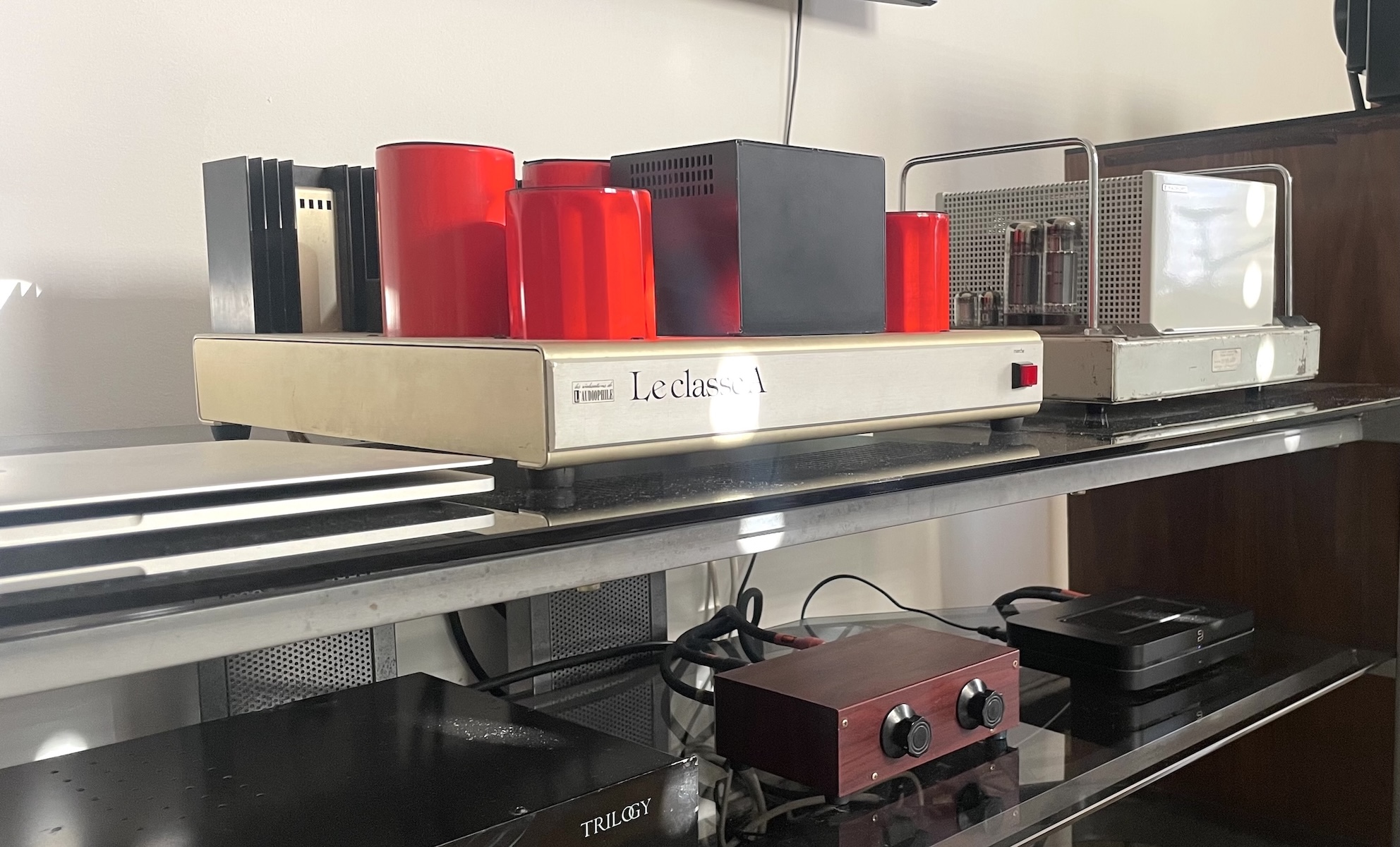

Hello everyone,
I am the owner of a L'audiophile Le classe A 30w power amplifier, built by Jean Hiraga.
I would like to ask for some help identifying an original component and understanding a change I noticed after a recent repair.

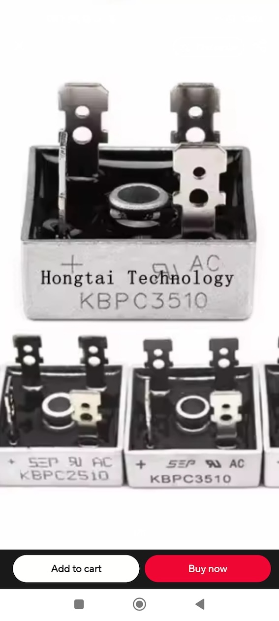

The amplifier developed a fault, and the technician found that the main diode bridge rectifiers in the power supply had failed. He replaced them with newer, higher-current bridges.
According to the technician, the original diode bridges were working quite hard and becoming very hot. He therefore chose stronger replacements, mainly to give the amplifier more safety margin and improved reliability.
The nominal amplifier supply rails remain approximately:
+25v / 0v / -25v
the diode bridges were the only components replaced during the repair.
The technician sent me a photo of the new bridges that were installed, which I will attach to this post.

Ok,
My technician found the exact model of the original diodes bridges
the original: pb86
the new ones: kbpc3510
the problem is can't find any sources how has the pb86 in stock.
if someone can help in that regard I will be very grateful.
RE: L’audiophile Le Classe A 30W — diode bridge replacement and possible sonic changes - Wagtbtoobz - 22/08/2026
Hi,
Just avoid those sh... ch.... fakes... try to find a genuine International Rectifier or , better, Semikron , and push to 4 stacked // of them... Wink
